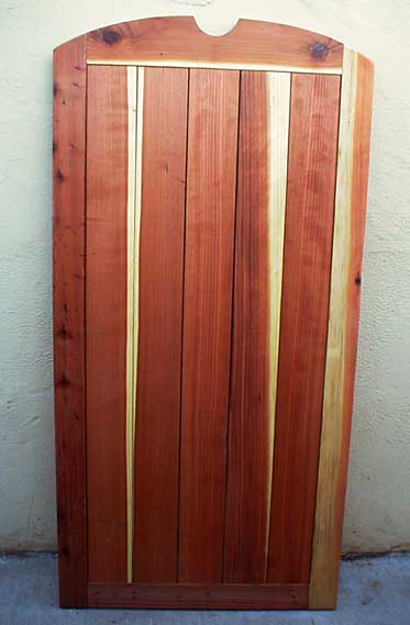

Mitered Corners 5'x7' Gate Frame *LINK*
charlie belden
>Four 10mm (0.4") thick loose tenons, each a tad under 2" long, in the mitered corners of 2x4s - pressure treated since its for a garden gate frame on which netting was stretched to keep rabbits and deer from eating the crop. 32 mortises cut by an absolute novice at woodworking after I showed him how the DOMINO worked on a pair of mitered scraps. ALL cut with the piece laying flat on my miter saw tables - no clamps.
For a wide front door you could probably do six mortises on each part. And large doors are typcially paneled so the shear load is taken up by at least three horizontal members - plus the panels.
The attached photo is of a gate I did - for a garbage can surround. All joints epoxied because this thing sits outside in the elements - such as we have in the SF Bay Area.
Dominoed Mitered Corners of Tall Gate
